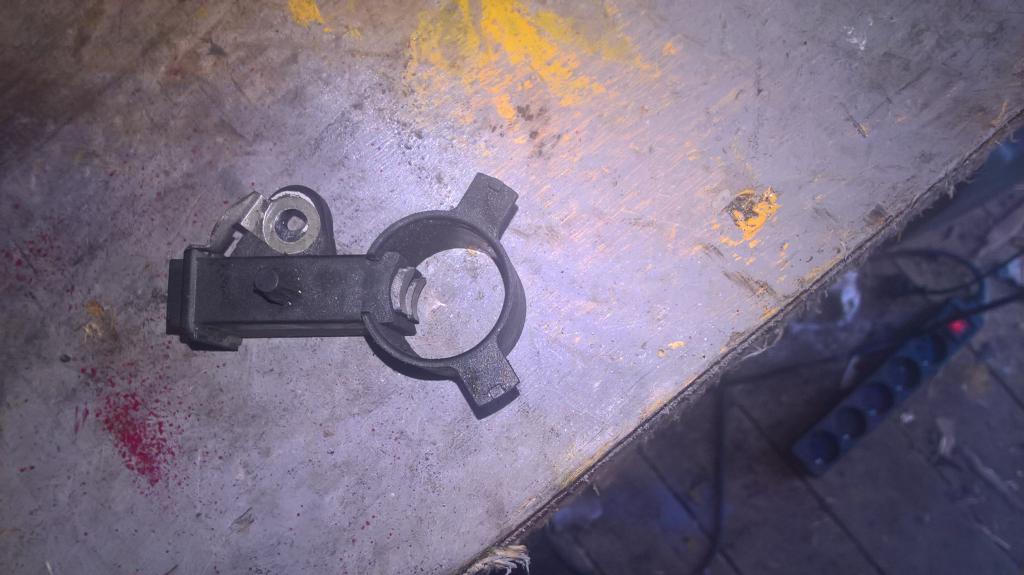

Laturin arse avattuna...
https://forums.offipalsta.com/attachmen ... 1492704351
Ja hiilet...
